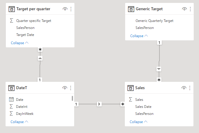

See attached PBIX:
Sales Target reached example.pbix (93.2 KB)
  1. Data model including two target methodologies per sales person: a specific target per quarter and a generic target
    Note: presumably Generic Quarterly Target will not be used, as it will be a target over years, as the table “Generic Table” does not contain any dates
  2. Measures set up for “Quarter Specific Target” and “Specific Target reached
