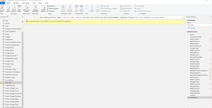

@Melissa, I implemented the Add24HRaw into my actual pibx file and I got the following error:
Hi @leo_89,
Your Table reference, the first argument, is pointing to the query (itself).
You need to replace that with #“Changed Type6” you will also need to check and possibly update that for the other steps you copied over.
