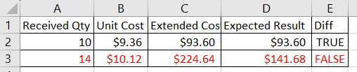

I’m trying to create a DAX multiplication function. However, The results do not always match expected. See example below.
Can someone please help me with the DAX and concept?
Extended Cost = vw_abc[Qty]*vw_abc[Unit Cost]
DAX Results
Many thanks!

Hi @jbunavicz - Can you try something like below.
Extended Cost = if(HASONEVALUE(Test[Unit Cost]),max(Test[Unit Cost]) * max(Test[Qty]),Sumx(test,Test[Unit Cost] * Test[Qty]))
