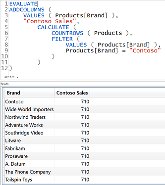

Here is a small Sunday fun challenge for all of you:
This is the data model containing only Products table:
DAX Challenge 3.pbix (35.6 KB)
This is the Code with result:
Challenge - You need to only show 710 for Contoso and not for other Products
Caveats -
  1. You are not allowed to use IF as a quick and dirty solution
  2. You cannot change the ADDCOLUMNS, & FILTER + VALUES part
  3. You need to explain why the code is working
The code was written in DAX Studio, but you can do in Power BI.

FILTER ( VALUES ( Products[Brand] ), Products[Brand] = “Contoso” ) this statement will ensure that a table of only only one value is returned i.e contoso.
Caclulatetable and keepfilter will ensure that the filter stays on Contoso when the values(Products[Brand]) is traversed.

@AntrikshSharma ,
Good one – I always enjoy these challenges from you. I was hoping to find a way to annoy you by using a simple COALESCE based solution instead of an IF statement to get you back for Rickrolling me earlier this week. But you smartly tightened the hatches in your rules and I couldn’t get it to work.
Note: I had originally written this using FILTER instead of the CALCULATETABLE function, but the solution only works with the latter.
This works because the way you had originally written Contoso Sales overrode the filter context from brand, but KEEPFILTERS restores that context subject to the condition in the KEEPFILTERS statement.
Thanks for putting this together and posting it.

Here is my solution
Adding calculate without filter arguments, we can keep filter coming from context transition

This text will be blurred[/spoiler] Introduce a friendly and helpful DAX modifIer to create an intersection of the values and maintain the current filter context.
@Craig What’s the current filter context here? :stuck_out_tongue_winking_eye:
