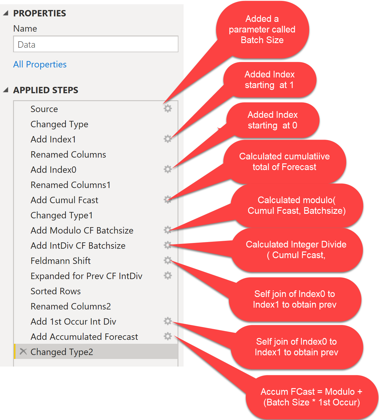

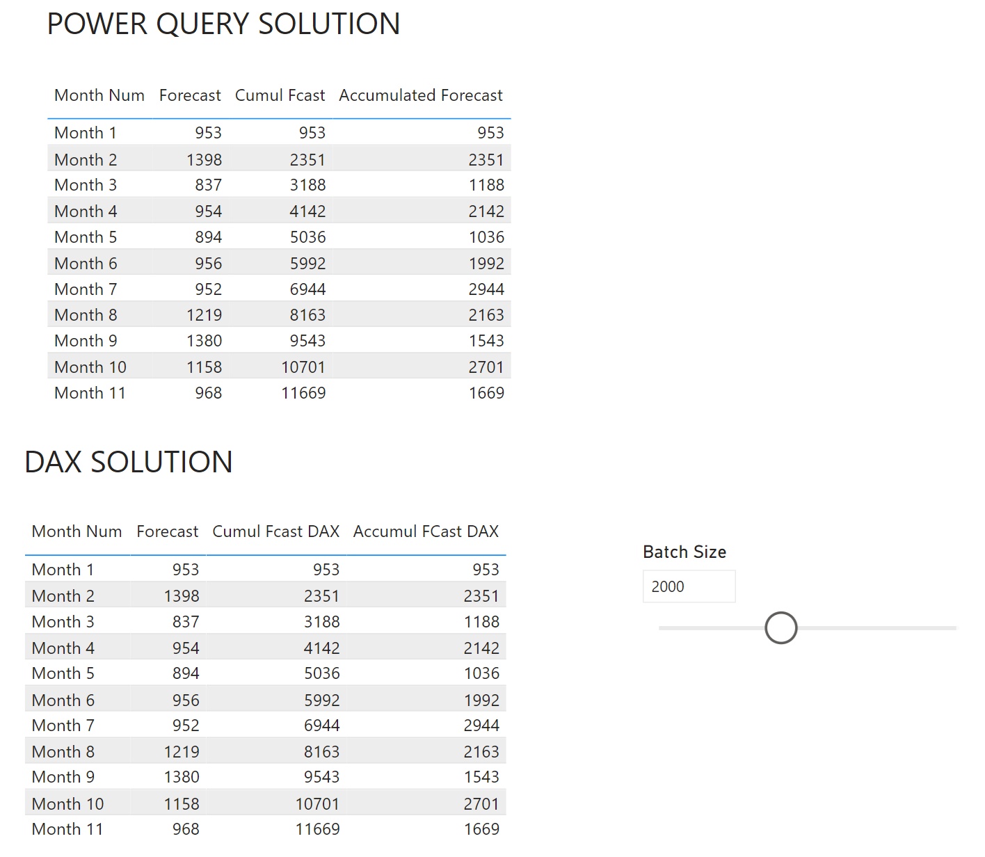

OK, got it. Super fun problem to work through. I worked it through in PQ/M, but now that I’ve got the algorithm, should be straightforward to replicate in DAX if you’d like. Here’s what I did:

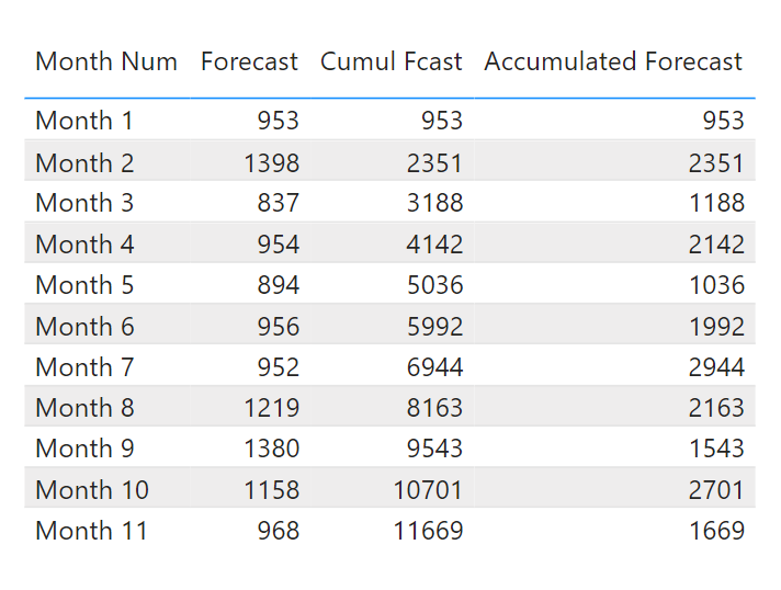

Here’s the result:
And here’s the full M code:

I hope this is helpful. Full solution attached.
  • Brian

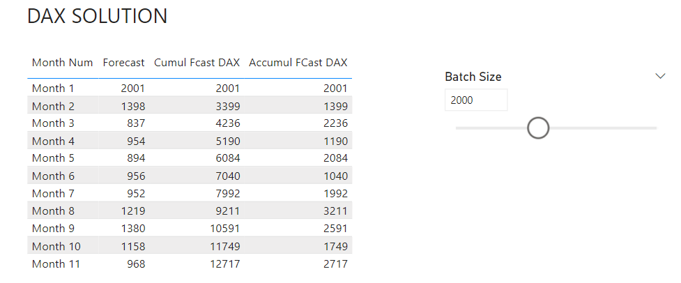

Hi @BrianJ,
With the idea of learning I was trying to solve this problem with DAX. Once I had seen that it worked with the example, I modified the excel values to see if I got the same result but there were some differences, so I thought that the problem was not solved.
After seeing your solution, I realized that the problem was in the excel of the example, which does not work for any initial value of the forecast.
I send the solution in DAX in case it can be useful to @andersenjeff5. Any comment from you will be welcome.
Thank you very much
Batch Size Forecast_JAFP.pbix (26.5 KB)

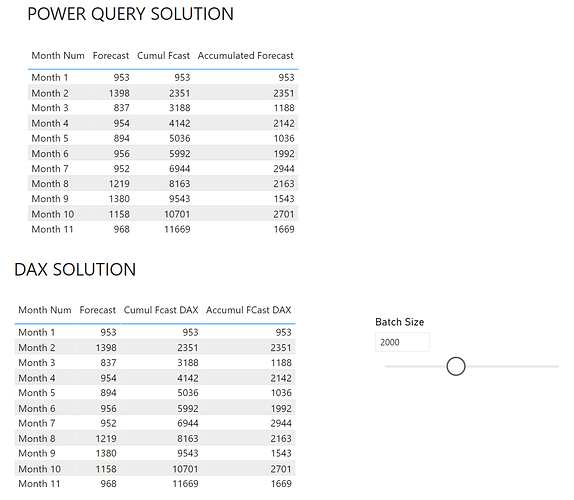

@jafernandezpuga ,
Nice work. I also had implemented a DAX solution today (just a literal translation of every column in my PQ/M solution into a DAX measure) using the original forecast data, and adding a what-if parameter for batch size. I will run my model with your revised data just to confirm that we’re getting the same results.
Solution file attached.
  • Brian
eDNA Forum - Batch Size Forecast Solution.pbix (29.9 KB)
@jafernandezpuga ,
Bingo! Our results match exactly with the revised forecast data.

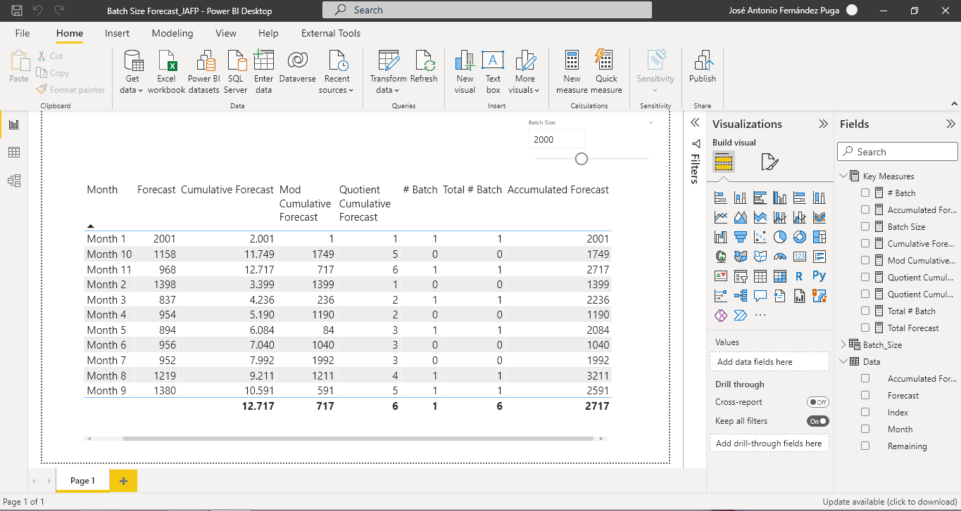

@BrianJ ,
I have been asked a follow up on this question as well and wondering if you could offer some more help. For when the batch size is removed from the forecast by the MOD formula, could there be a result of the count. Example from above, in month 2 the cumulative forecast above was 3399 and it removed the 2000 batch size, is there a way to give a result of ‘1’ since that is the number of batches it removed for the forecast and also in month 5 where it removed 4000 it would give me a result of ‘2’. For all other month where it did not have to remove the batch size from a month it would give me ‘0’

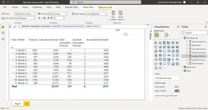

Hi @andersenjeff5 and @BrianJ,
In the solution I shared is the measurement you need:
Quotient Cumulative Forecast = QUOTIENT( [Cumulative Forecast] , [Batch Size] )

Hello @andersenjeff5 ,
We can calculate it by subtracting the current value of [Quotient Cumulative Forecast] minus the value of the previous row:
.# Batch = [Quotient Cumulative Forecast] - [Quotient Cumulative Forecast Before]
And this other one so that it correctly calculates the totals:
Total #Batch =
IF(
HASONEVALUE( Data[Index] ),
[#Batch],
SUMX(
ADDCOLUMNS(
VALUES( Data[Index] ),
“@#Batch”, [#Batch]
[@#Batch]
Regards,
Batch Size Forecast_JAFP.pbix (28.7 KB)
