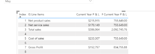

Hi,
I have a file that contains current year actuals and current year forecasts.
At the end of each month finance then reforecasts for the rest of the year.
The p&l forecast contains two date columns - the date in which it is forecast to happen (Date) and the month end in which we have forecast (Forecast date).
We would like to be able to keep all of the prior months forecast as we would like to see at the end of each month if our forecasting is improving…
I am really stuck on this measure and how to go about this so i have tried to attach a dummy file that i have created to mimic the file and outcome i am trying to achieve.

Hi @Suzie - If needed to keep track of previous months forecast, then can you use Matrix visual as shown in Page 1 of attached PBIX.
Data Example.pbix (117.7 KB)

Thanks for providing some solutions. The problem I am facing through is that I need a dax measure that will pick up (current month -1) from the forecast column to correctly calculate what the values for the forecast will be.
There are two dates within the forecast table Date & Forecast Date. The date is linked to the date table where as the forecast Date represents the date for the month in which the forecast was completed for comparison to actuals.
