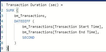

DATEDIFF on SECONDS results in OVERFLOW, after a few months of data
I have these columns:

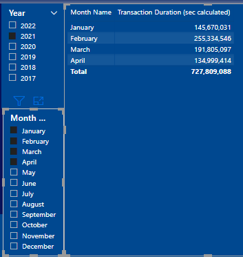

I’m using this DAX calculation:

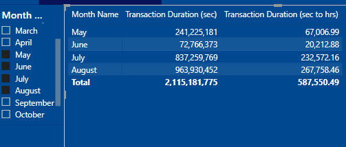

The result is working fine…

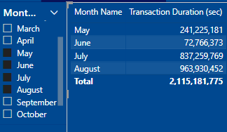

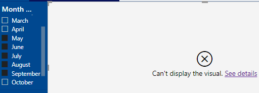

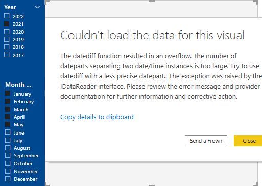

…Until I add another month:
Then I get this error:

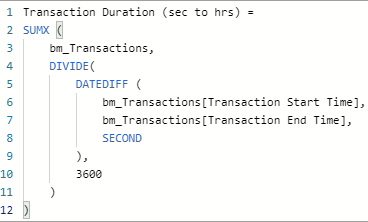

My best idea was to DIVIDE the SECONDS by 3600 to get HOURS:
Hoping for smaller units = less bits = no error:

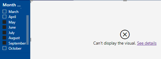

But to no avail, same error appears:
Additional Info:
Fact Table is DirectQuery from SQL Server
32M+ Rows over 5 years
9 Columns
Anyone have any idea on how to resolve this?

Transaction Duration BEFORE (sec) =
SUMX (
bm_Transactions,
DATEDIFF (
bm_Transactions[Transaction Start Time],
bm_Transactions[Transaction End Time],
SECOND

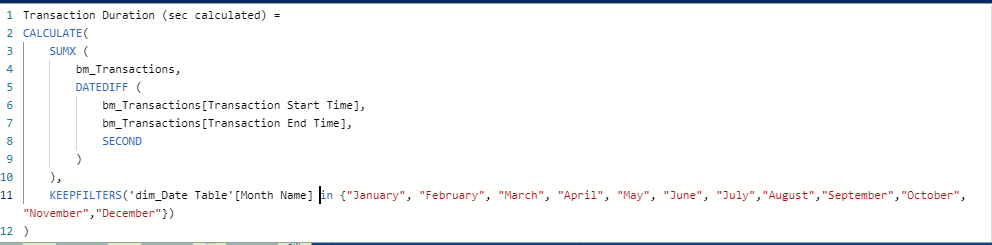

Transaction Duration AFTER (sec) =
CALCULATE (
SUMX (
bm_Transactions,
DATEDIFF (
SECOND
The name of the game here is to use the CALCULATE function and it’s conditions to make the measure calculate as little information as possible.

Tried this:
Returns same values, which is good:
but same error occurs when I add another month:

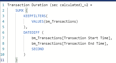

Also tried this, with same error:
Dang. The only thing I can think of is to add a KEEPFILTERS argument for the year in case it’s calculating other years in the background.

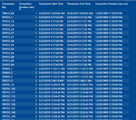

And, I definitely can’t settle for it because a ton of transactions with durations under 60 seconds become 0 minutes as the image below shows:

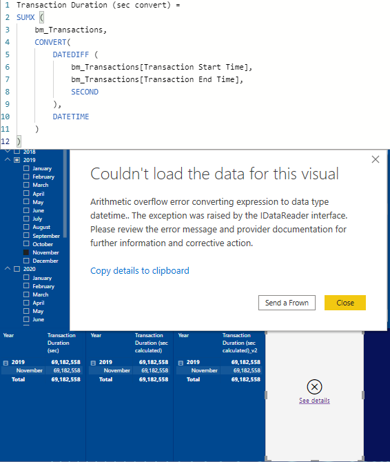

Have you tried taking the aggregated integer and converting it back to a DateTime with CONVERT?
I have not, but then what do I do with the DateTime value? Will I aggregate it again? When will the total seconds appear on my monthly chart?
I’m not entirely sure, it’s a little hard without a file to work with. I was thinking you might be able to wrap the output in the original equation in a CONVERT function to override it turning it into an integer. You’re unfortunately pushing the boundaries of DAX’s ability to compute at the moment.
I did this but same error:

And after looking at your equation again you’ll want to change “INTEGER” to “DATETIME”. It’s asking what you want to convert it to.
using CONVERT with DATETIME resulted in an arithmetic overflow error:

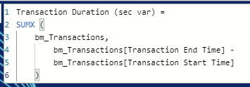

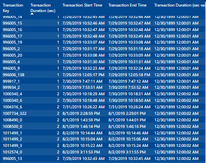

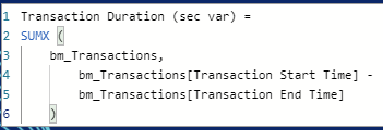

some interesting news…
If I remove DATEDIFF and just use a Subtraction operator…
…some kind of DateTime value becomes visible for all the months:
which seems like the difference in seconds moving backwards from the beginning of data-time (12/30/1899 00:00:00):
so when I reverse the order of the operand:
the difference is the number of seconds moving forward starting from the beginning of data-time (12/30/1899 00:00:00):
soooo with this DAX, I think it worked:
buuuut, still breaking at the visual:
