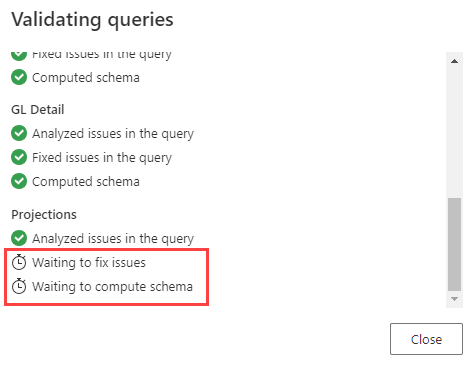

However, with this set of queries in dataflows, I click the Save & Close button and the last query fails in the Validating queries process. The last query that failing is appending around 6 previous queries into a single table. I put in some Table.Buffer functions at the end of the queries that are being appended. I also changed it so uses the advanced append to append all 6 queries in a single step.
However, when I click Save & close, it is stuck Validating queries - Waiting to fix issues.
I re-ran and then got this error message…
Any advice?

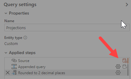

Can you post the M Code for “Projections” Query here? Also, check on the query list to the left. Does it show a lightning icon next to Projections query table icon? Also, can you post the full error message you get when you try to refresh in the service?
