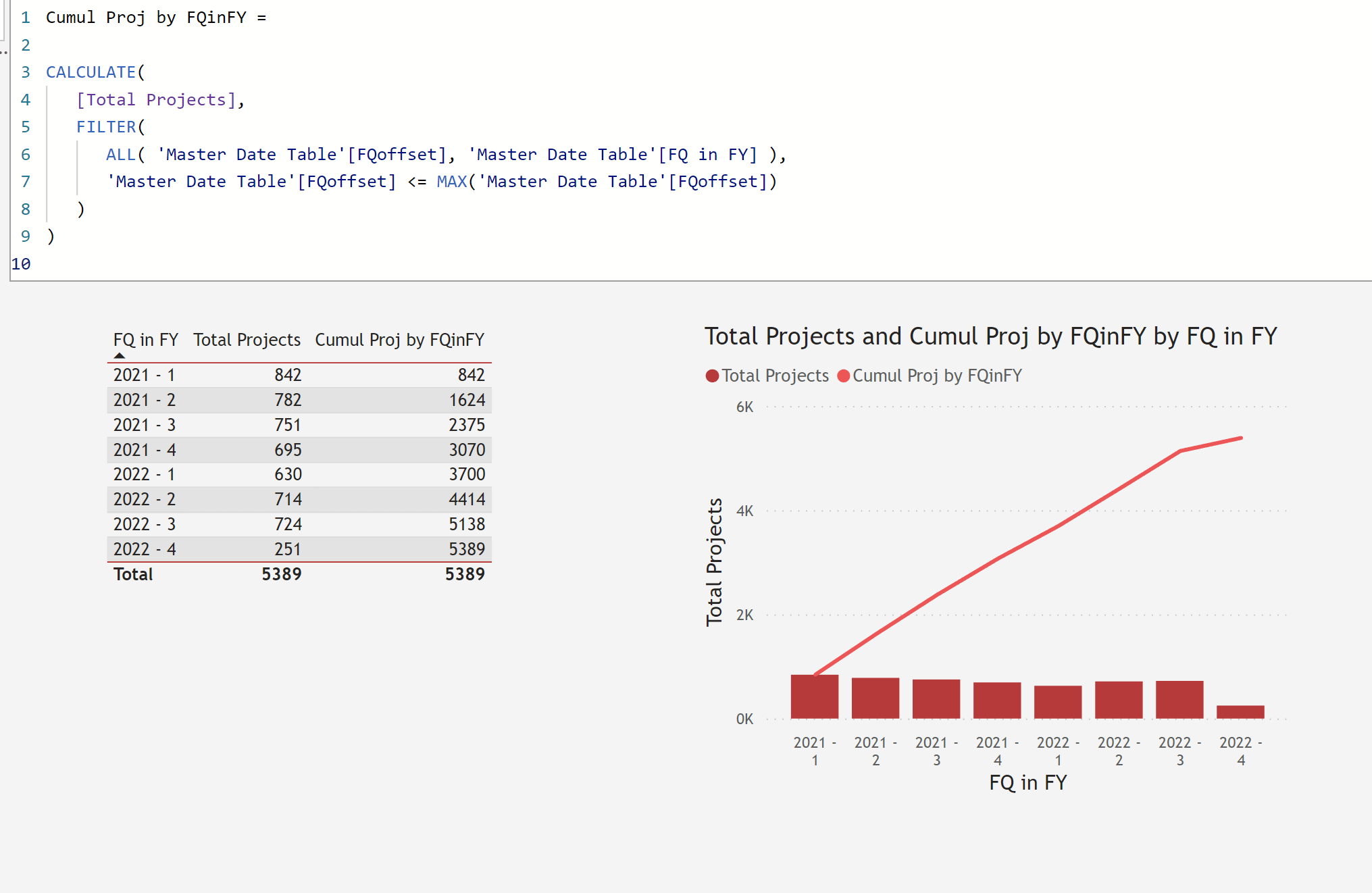

I watched the video and I use the Offsets most times. What I can’t get past is the how the data is set up as a running total. So no matter what measure I create I don’t know who to change the measure into using the last month of the Quarter or Year as the number to present. The measures allways want to sum up the values.

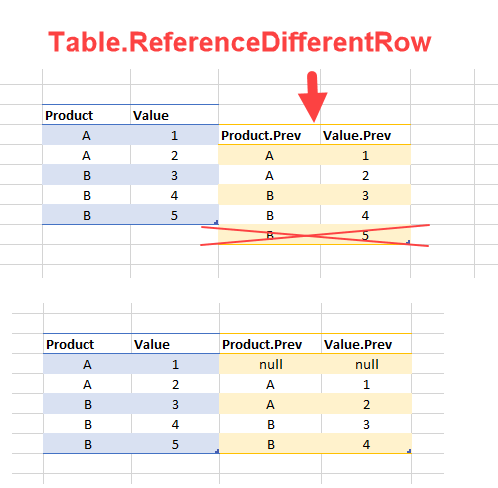

@chad.sharpe ,
Oh, wait - I think I see what you’re getting at here in terms of the initial data being running total. I ran into the exact same problem with the Johns Hopkins COVID Data in Data Challenge 10.
Use the “Feldmann Shift” to obtain the previous period value in Power Query. The take the difference between those to to calculate the delta for each period. This will express the data in units per period, not cumulative units per period. Makes everything MUCH easier to work with, and you can always aggregate UP to cumulative totals using the approach above.
I hope this is helpful.
  • Brian
Yes, this is the issue I seem to have. I’ll read it through…
