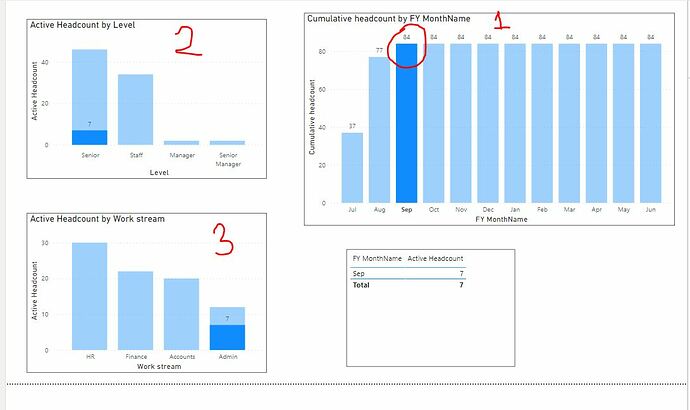

I have came across a scenario when i click on a cumulative visuals for a particular month, others visuals should get filtered for that cumulative total, but instead of this visuals are getting filtered for the actual month total.
Here is the snapshot to explain what i have been looking. If i select september month in chart 1, i want to see the break of cumulative total break which is 84 on chart 2 and chart 3.

Well the reason why “Chart No. 2” and “Chart No. 3” are getting filtered and showing the results for only that particular month is because the values supplied in those charts are the “Active Headcount” measure i.e. values for that particular individual month rather than that replace it with the “Cumulative Headcount” measures in those two charts and visuals will show the values getting filtered out cumulatively.
