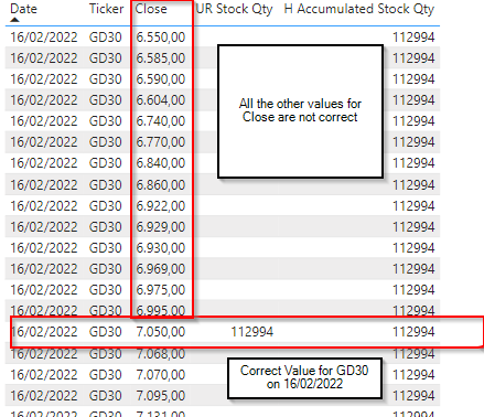

Hello @Paul.Gerber! Thank you for your answer.
I’m using ALLSELECTED and now it appears to be accumulating the values but a problem occurs. Now the column in the table “Close price” it’s showing values that doesn’t correspond to the specific ticker.
I’m not sure if I need to correct the measure or the data model.
I’m adding a picture below, hope it helps make it clear.
@aoh I would look closely at your relationships. You have a bidirectional one. Keep a table as a fact table like Transactions. Then use TREATAS to get info from your Quotes table. I will work on this also.
You are missing dates in your dates table.
Paul
