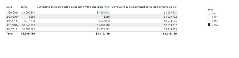

I am trying to understand why one measure works and another does not. I have a simple model with a Sales Table (Adventureworks) and a Dates table. The Adventureworks Sales table does not have sales on every date but rather only on a few selected dates. And I want to calculate cumulative sales and only display dates with sales. I found a measure on this board that works and I have pasted it below, however I thought another measure would also work and it does not. So my question is, why is the 2nd measure not working? Thanks!
This measure from Sam works…
Cumulative Sales allselected dates table remove blanks =
var CumulativeSales = CALCULATE([Sales],
FILTER(ALLSELECTED(ā€˜Dates’),
ā€˜Dates’[Date] <= MAX(ā€˜Dates’[Date])
RETURN
IF(ISBLANK([Sales]),BLANK(),CumulativeSales)
in this Measure, I used a table filter on the Sales table but when I do this, the cumulative part of the measure does not work. I guess the ā€˜Sales Orders’ table filter is overriding the Dates filter above? Is there another way to apply this filter? Is the If(ISBLANK() solution above the only way to tackle this?
Cumulative Sales allselected dates table with Sales Table Filter =
CALCULATE([Sales],
ā€˜Sales Orders’

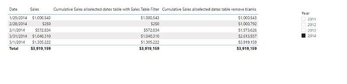

Here is the result of the two measures…
Thanks!!

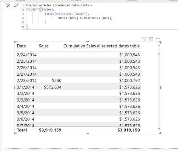

@AntrikshSharma , Thanks for sharing your video. It was very interesting. However I am not certain what to take from it in the context of my issue. I believe you are suggesting that I should not invoke the expanded table in my measure by referencing the ā€˜Sales Orders’ table as a filter. However if I don’t do that and if I don’t use the If(Isblank()) evaulation then all dates from the ā€˜Dates’ table are listed in the visual. (See attached.)
So, is the ā€œIf(Isblank()ā€ evaluation the best solution to remove the dates with no values in the ā€˜Sales Orders’ table or is there a better solution? I keep thinking that there is a way to filter rather than use the If statement. Thanks again for your help!
