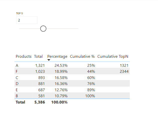

Cumulative Percent based on Product & TOPN without dates
How to calculate cumulative percentage based on Product wise including TOPN.
In my data model have no dates.
It would be great if you could resolve in attached file.
Sample Data Cumulative Percent.pbix (31.0 KB)

Here is the solution for your query and the PBIX file
DAR Measure 1
Cumulative % =
VAR _Rank = RANKX(ALL(Products[Products]), [Percentage], , DESC)
VAR _Cumulative = IF(HASONEFILTER(Products[Products]),
                CALCULATE([Percentage],
               FILTER(ALL(Products[Products]),
               _Rank >= RANKX(ALL(Products[Products]), [Percentage], , DESC))),
               BLANK())
Return
_Cumulative
DAX Measure 2
Cumulative TopN =
VAR _Rank = IF(ISBLANK([TopN Total]), BLANK(), RANKX(ALL(Products[Products]), [TopN Total], , DESC))
VAR _CumutiveTopnN = IF(HASONEFILTER(Products[Products]),
                 CALCULATE(
                           [TopN Total],
                           _Rank >=
                           RANKX(ALL(Products[Products]), [TopN Total], , DESC)))),
                 BLANK())
Return
_CumutiveTopnN
Sample Data Cumulative Percent_dharma.pbix (31.7 KB)

Could you please fix the total? It’s showing blank.

You can remove the Hasonefilter condition from the measure, I have written that to make total blank…
