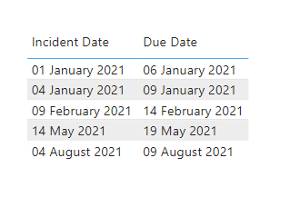

Hello @Julius,
Well, this is achievable by writing a small simple measure. Below is the measure alongwith the screenshot of the final results provided for the reference -
Due Date =
IF( ISINSCOPE( Data[Incident Date] ) ,
    SELECTEDVALUE( Data[Incident Date] ) + 5 ,
    BLANK() )
Final Results
Thanks and Warm Regards,
Harsh
Due Date - Harsh.pbix (610.6 KB)
