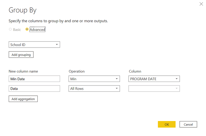

@MIchaelGordon ,
We are using the same data file, just with a different path. To change the path in power query just follow these three steps, and then browse to the First Occurrence.xlsx data file on your computer.
Once you’ve done that, you’ll be able to browse my steps in PQ. You’ll see that your grouping step is different in that I used the All Rows operation in addition to the minimum. This is what maintained the columns in my table.
If you’re not familiar with the All Rows operation, I did a recent video on it and in combination with Group By, It’s one of the most powerful functions in Power BI and can be used to easily solve almost any grouping related problem.
Sorry – should have been clearer about this in the email with my initial solution.
Hope this gets you what you need. Just give a shout if it doesn’t.
– Brian
