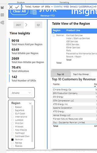

Hello. Paul here again. I am trying to count number of work orders. But the column in the data has both numbers and text. So when I do COUNTROWS or COUNT, my value is lower than the raw data. It’s context is by Region. Help.
Total Number of SROs = COUNTROWS( 'AMSS Detail ') + 0

Hi @Paul.Gerber. OK, another round. Got your new file, cannot match it with the screenshot provided in your first post introducing the issue. Please take a screenshot of the current state with all desired filters set appropriately, and markup the screenshot with what you expect to see. Your DAX code for [Total Number of SROs] differs as well.
Total Number of SROs = DISTINCTCOUNT('AMSS Detail'[sCOSRONum])+0

Hello sir. Thanks for looking. I have it opened now and included screenshots. What I’m doing is going to the data and filtering just for the Permian region, year is 2022, month is January. Under sCOSRONum for the data it displays 440 rows. Each SRO is designated to a particular product line. So when I have a measure to count the total number of rows, in my mind it should return 440 SROs. Not 142 as shown in the second picture. why the difference? Do I need to add a filter for all product line items? what is it counting. Many thanks

OK, looked again … can’t match your numbers. When I filter as you suggest for 2021 and January and Permian, I get 664, not 142. We’re missing something here. Perhaps repeat the screenshot circle the number of interest, and what you expect to get, and attach the specific file from which the screenshot(s) were taken.

Try January 2022
@Greg
CALCULATE( COUNTA ( ‘AMSS Detail’[sCOSRONum]), DISTINCT( ‘AMSS Detail’[Product Line]))
fixed
