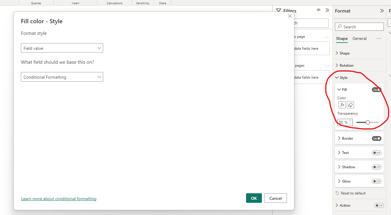

This is a bit of a workaround, place a shape over the header column you wish to “highlight”. PBIX file included at bottom of post.
I set the shapes transparency to 50% so you can see the text come through. The shape was brought to the front.
I created a basic measure which said if Returns Cost is greater than 0 then show the pink colour “#F0A787”, if not show “#FFFFFF00”…the additional zeroes at the end make the shapes colour transparent. I left the border on the shape so you can find it/see it easily but if you use this workaround you’d want to remove/turn off the border.
Add the conditional formatting measure to the conditional formatting section in the formatting of the shape.
PBIX for Rosalie.pbix (20.6 KB)

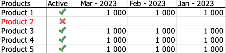

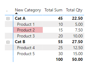

Hello and thanks for the replies. I see now why adding data helps with this forum. I am looking to conditionally format the ROW heading, not the Columns. (@DavieJoe - thanks for the tip though.)
In this example, Product 2 should be a different colour because it is not an Active product. So I want to conditionally format the product name (row heading) based on the value of the Active column. Hope that makes more sense!
(PS - this screenshot is from Excel.)

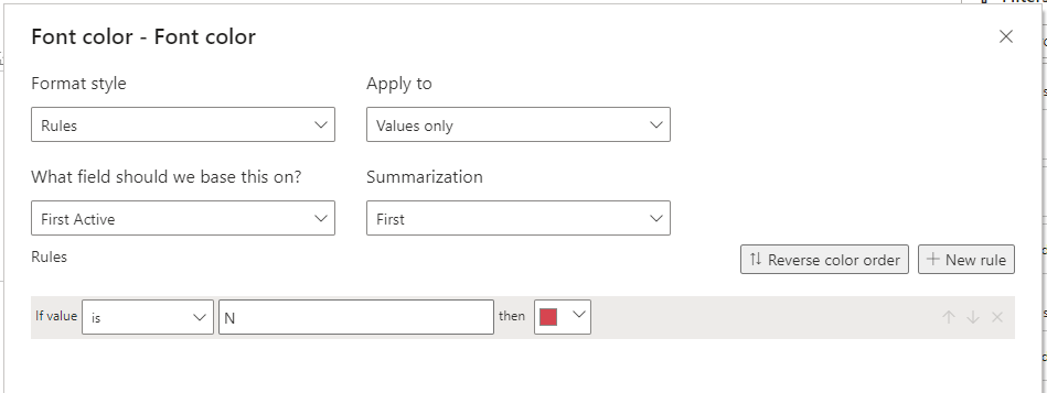

@RosalieMacartney - if the red color is supposed to based on the value “Active”, you actually don’t have to have that column on your Matrix table at all - so long as the row header can determine what the Active status is, it will work:
Active is not on the table at all, just used as a conditional format on the font color as @jamie.bryan showed above.
I’ve taken the sample from Jamie and added a value column (so that we can render a proper table), and removed the Active column - no other changes were made to that sample.
PBIX Rosalie (2).pbix (18.3 KB)

Appologies @RosalieMacartney - apparently I wasn’t fully awake when sending the earlier message.
However, I have found a work-around for you if it’s acceptable (and yes, it’s still a matrix table)
using the sample you sent me, here is what I have done
Step 1 - build a measure to return your row headers:
Header Measure =
IF( ISINSCOPE( 'Table'[Product] ),
    UNICHAR(127) & SELECTEDVALUE( 'Table'[Product] ),
    SELECTEDVALUE( 'Table'[Category] ))
note: the UNICHAR portion is just to add an indent to your Product lines
Step 2 - add this measure as the first value in your matrix
Step 3 - add the condition to the Header Measure value (because as a value it can accept conditional format)
Step 4 - turn off row wrapping on the row headers, and drag that column to be as thin as possible
Step 5 - rename the Category column (in the Matrix visual only) to something small like . or - so your users can overlook it
Result:
eDNA Solution - PBIX Rosalie (3-matrix).pbix (21.6 KB)

@Heather - Thank you. This works like a dream! I feel so clever now :wink:
