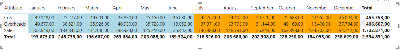

Hello everyone,
I am trying to invoke some conditional formatting whereby the actuals are highlighted in one colour and budget to go in another.
Attached is an example data set. If I have Jan-Apr as actuals and May-Dec as budget.
How can I highlight the actual columns (Jan-Apr) in one colour and the budget column (May-Dec) in another colour?
Any help would be greatly appreciated.
Thanks!

Hello
attached two screenshot where the conditional formating is applied according to the created measure
you can extend the formatting for the attribute as well but this seems overacting the visual

Hello,
attached the pbix file with the measure you can use in your visual.
Added a calendar table and linked it to your Sales table.

Hello - I tried this solution in my model and it worked - thanks so much for your help! Really appreciate it.

Hi @nikeshvalji - I have tried one measure and it is working for your sample dataset but this will be hardcoded. Applied this measure on Conditional Formatting.
Measure = if(month(max(f_sales[Month])) < 5,"Green","Red")
CF_example_Sol.pbix (44.7 KB)
