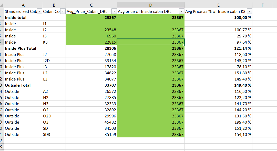

I need to compute Average price as % of Inside cabin total.
i.e. calculate Average price of Inside cabin (all cabins under inside category),
and use this value as Denominator for calculating percentage pr cabin code.
Here is how the final result should look like:

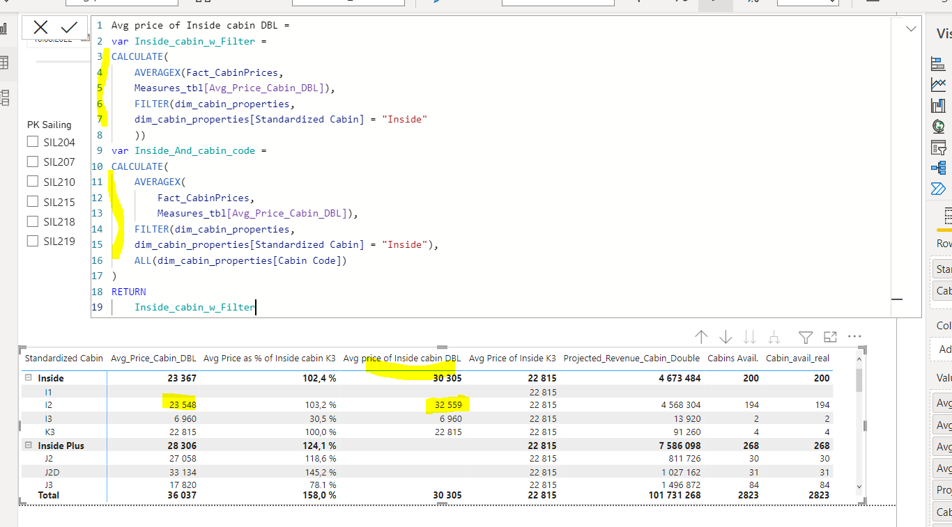

I have started from this Measure and the underlying result:

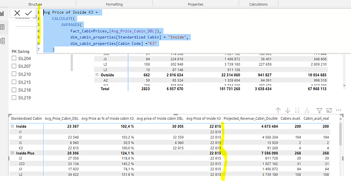

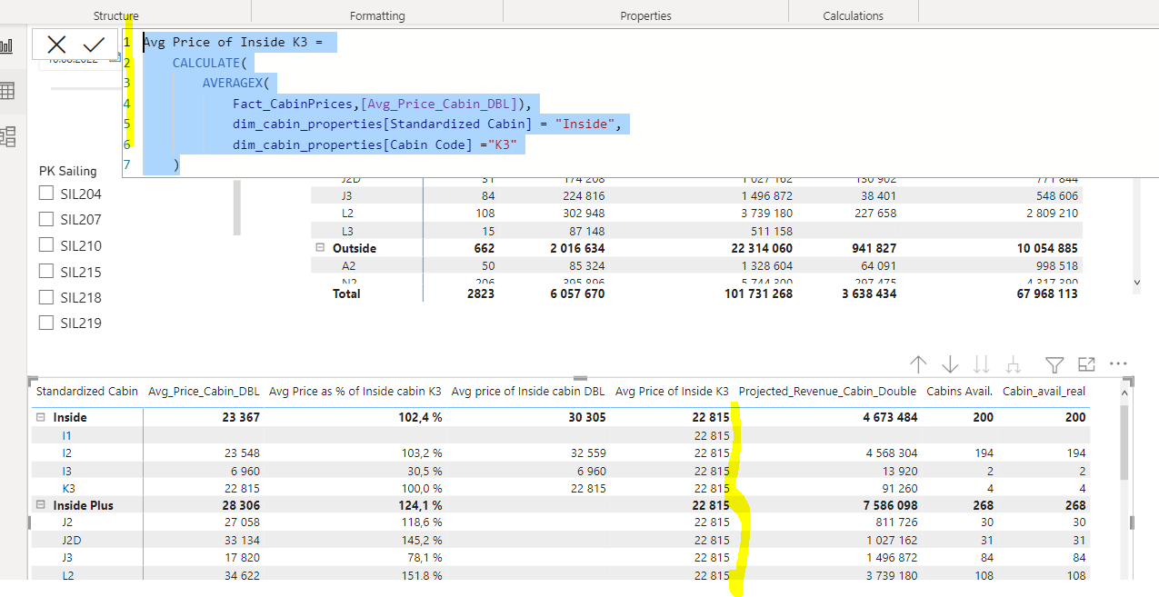

And I did some tests with following measures.
However the result was wrong
I do understand that my context is not properly build up for this Parent-child hierarchy and that’s why I need some help.

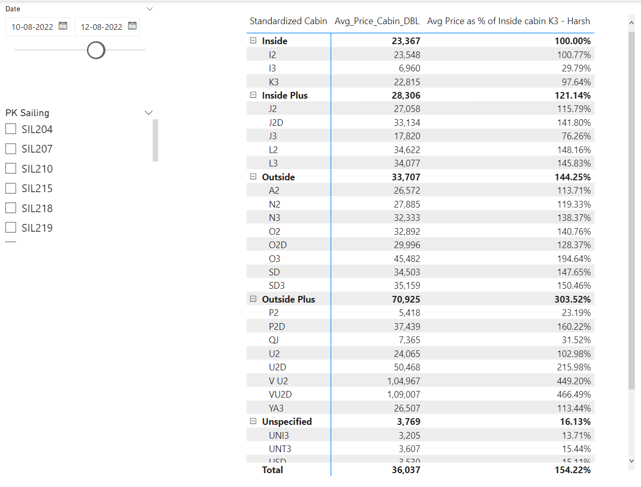

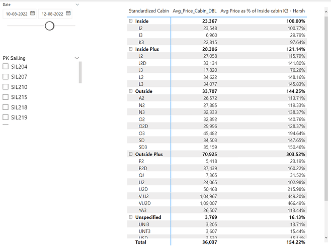

Once you write this measure, you’ll be able to see the desired results. Below is the screenshot of the final results provided for the reference -
Important Note: The % results that you’re showing in the form of Excel screenshot is actually incorrect. For example, when a figure of 27,058 (Inside Plus - J2) is divided with 23,367 it should be 115.79% and not 118.60%. This is happening for most of the rows that you’re showing. Please check once

P.S. you are right about the Excel screenshot. The mistake there is found out. :slight_smile:
