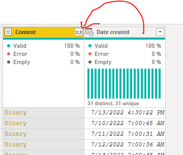

Hi everyone, how can I combine/merge the column “date created” when I expand the content? Thanks in advance :slight_smile:

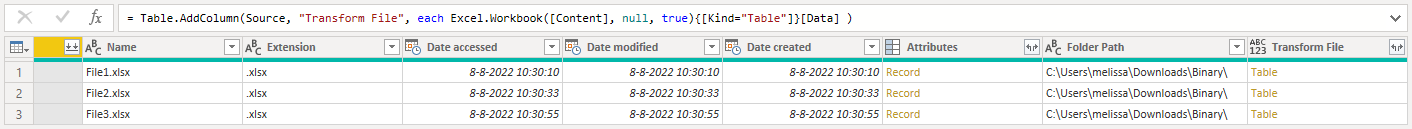

I see you’re getting files from a folder, in this example I’m using xlsx files to illustrate the process.

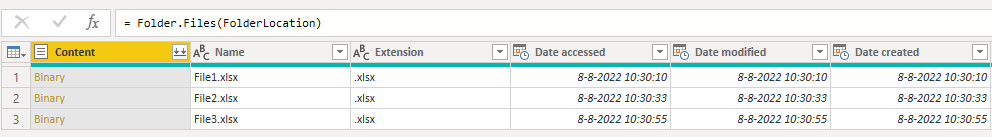

  1. Connect to the folder
  2. Add a transform step. Here I’m converting the binary content with Excel.Workbook([Content], null, true) and perform a lookup on kind equals table + extract what’s in the ‘data’ column {[Kind=“Table”]}[Data]

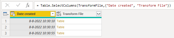

  3. Select the columns you require (in the order you prefer)

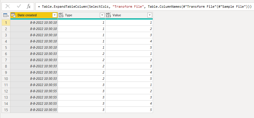

  4. Finally, expand the data

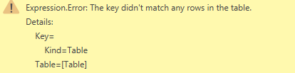

Hi @Melissa , thanks for taking the time on this. I am not sure how to add the step on my use case as I am using folder from FTP. I filtered the common folder using this method and eventually combine it afterwards. I did your method and throws an error which I am not sure what it was :sweat_smile: Here’s my query.
Hi @ronald_balza,
You’ve incorporated the Table.AddColumn syntax as a third argument to Table.SelectRows. There’s a missing closing parenthesis after Comparer.OrdinalIgnoreCase. Once you’ve added that you’ll need to declare a variable name for the Table.AddColumn transformation and update the table reference in its first argument.

Hi @Melissa again, appreciated your time taking on this. I had changed the file type into csv which still gave me an error. (although file type is .txt)
= Table.AddColumn( #"Filtered Rows", "Transform File", each Csv.Document([Content], null, true){[Kind="Table"]}[Data])
I removed true parameter and still gave me the error
Thanks very much for your assistance :slight_smile:
Hi @ronald_balza,
I keep getting bits and pieces of vital information… When not dealing with Excel files you are right to change the Excel.Workbook function into Csv.Document but its parameters are different. Nor do you need to perform key match lookup because is it not possible to have multiple sheets, ranges and/or tables inside a txt/csv.
