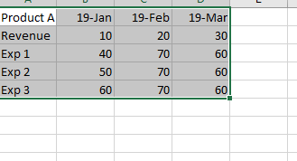

I have a few tables that I need to combine.
Below is an example of the input tables (source files - and these are in a folder),
The expected result after appending the tables should be,
Column 1 - Product name (i.e. Product A / B / C , etc)
Column 2 - Account name (i.e. revenue, exp 1, exp 2, exp 3, etc)
Column 3 - month
Column 4 - values
Could I please get some help on how I could achieve this?

Here is a sample file.
Please note, I have set up the files as worksheets within the workbook attached - in reality, each worksheet sits inside different Excel Files.
