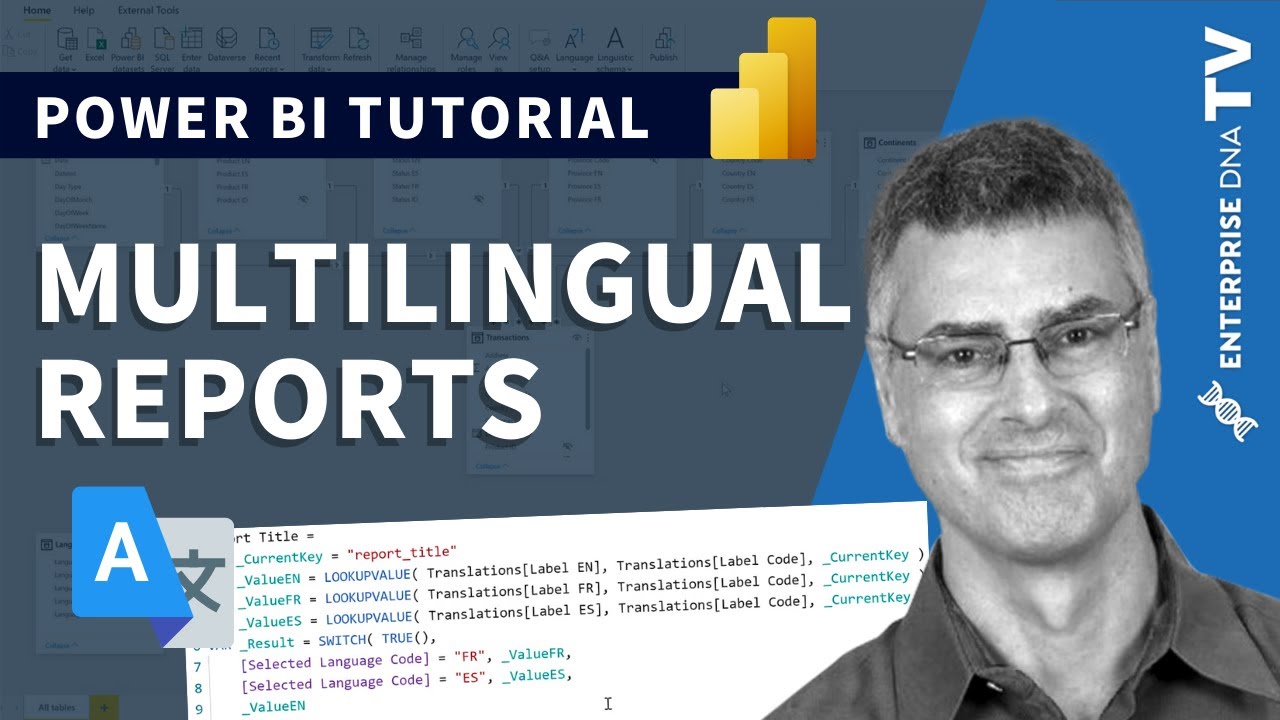

Here’s a YouTube I did a couple of years ago on one possible solution:

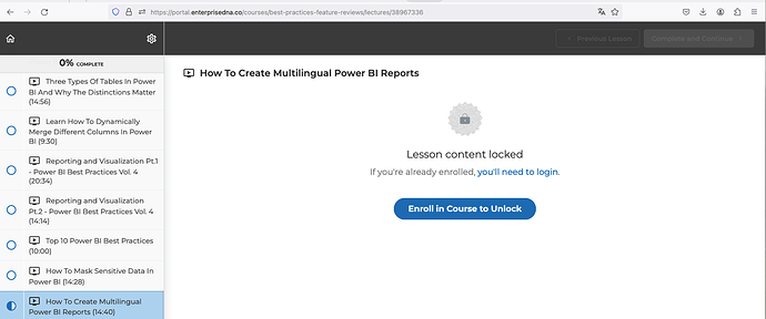

Hi Greg, firstly happy new year. I had doubts about one or another item in this video, such as the selectlanguage measure, so I entered the platform to take the course and as it was remodeled I couldn’t find it anymore, is there any way to have access again, I really need this solution. Thanks

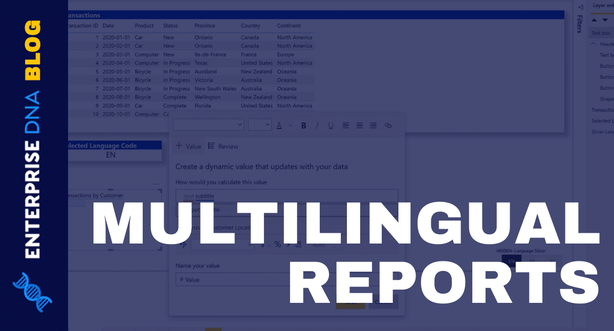

Here’s a link to the Enterprise DNA Blog post on this subject:

Hi Greg, thanks for the support. I accessed the base image below via the YouTube link and it took me to a page that I think is old from eDNA. I’ll put the image.
Unknown … @EnterpriseDNA … please pursue.
