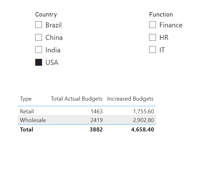

  1. When there is a filter(Slicer) on only Country like for example USA I want the budget to be increase by 20%
Type Sum of Budget Percent Increase
Retail 1463 1755.6
Wholesale 2419 2902.8

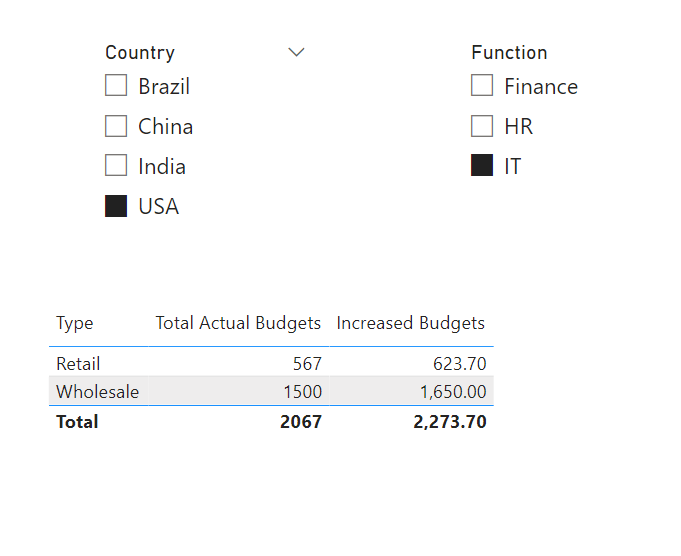

  1. When there is slicer of Country - USA and another slicer i.e function - HR then budget should be increased by 10%.
Retail 567 623.7
Wholesale 1500 1650

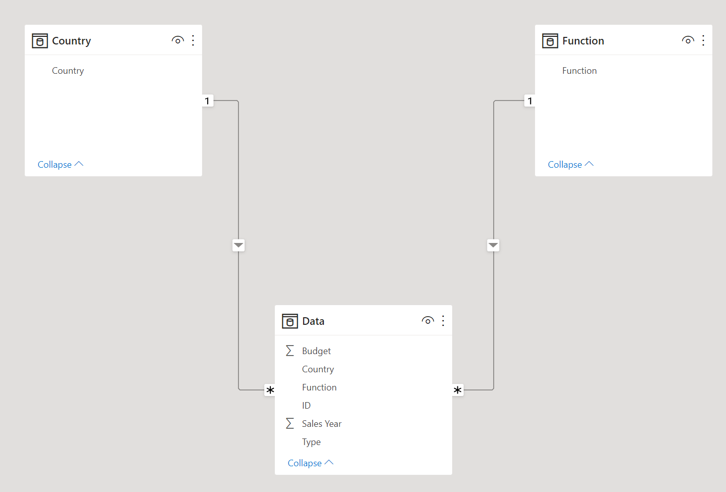

In order to achieve the results based on the condition that you’ve specified. First we’ll convert the flat file into the proper data model. Below is the screenshot of the data model provided for the reference -
Once that’s done. Write the below provided measure -

Below are the screenshot of the final results provided for the reference -

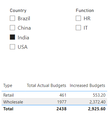

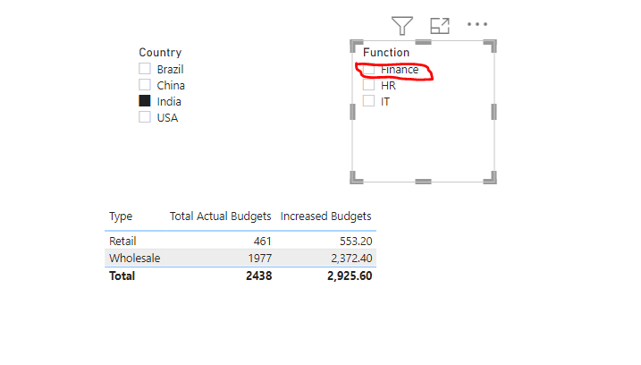

Hello @Harsh ,
The reason I used one table initially because I want my function slicer to be updated based on country filter like you see here when I filter country - “India” I also see Finance function in filter which should not appear ideally because there is no “finance” function under country India.
Is there a possibility where the function slicer to have drop down of values only based on the selection we make in country filter ?
Hello @Dharma,
It’s not a big deal. You can do that by putting a measure inside a filter pane by selecting the Function slicer and put the condition as “Total Budgets > 0”. Below is the screenshot provided for the reference -
Filter Pane for Function slicer
Once you do this, now you’ll see only “HR” and “IT” as a result for “India”. Below is the screenshot provided for the reference -
