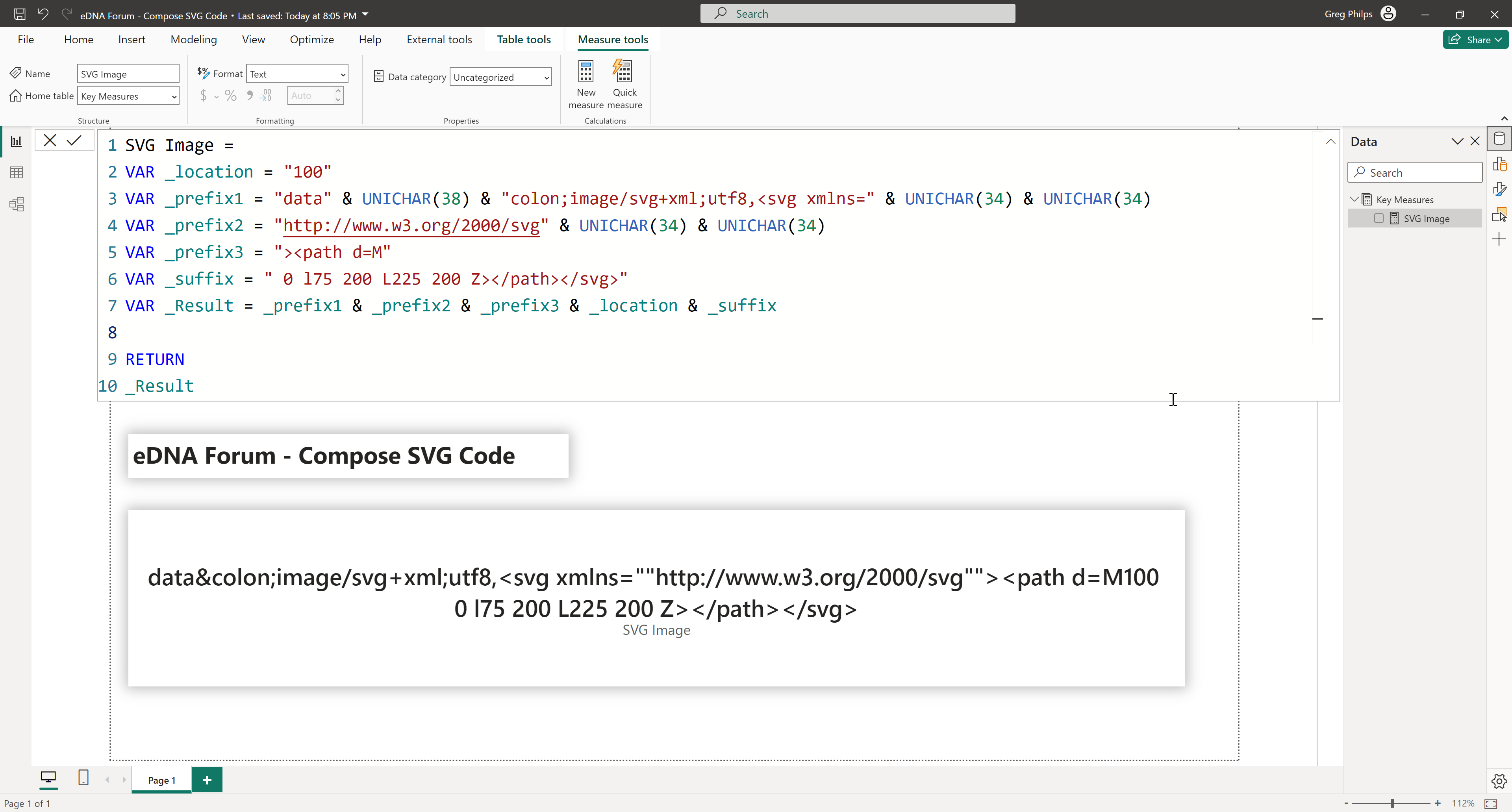

You can use UNICHAR codes to add special characters to text strings. Here’s a sample measure and a screenshot of the result:
Here’s the code for the sample measure:
SVG Image =
VAR _location = "100"
VAR _prefix1 = "data" & UNICHAR(38) & "colon;image/svg+xml;utf8,<svg xmlns=" & UNICHAR(34) & UNICHAR(34)
VAR _prefix2 = "http://www.w3.org/2000/svg" & UNICHAR(34) & UNICHAR(34)
VAR _prefix3 = "><path d=M"
VAR _suffix = " 0 l75 200 L225 200 Z></path></svg>"
VAR _Result = _prefix1 & _prefix2 & _prefix3 & _location & _suffix
RETURN
_Result
You can adjust to suit. Hope it helps.
