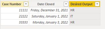

I would like to get a calculated column in the ‘Fact Table’ which displays the latest value (I’ve used activity number to determine the latest) with those rows which has ‘Case Cue’.
For example:
Case Number Date Closed Desired Output
11111 31/12/2021 HR
22222 1/1/2022 IT
33333 3/1/2022 HR

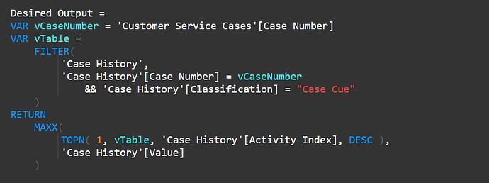

I have tried using this DAX formula:
Desired Output =
VAR MaxIndex = CALCULATE( MAX(‘CaseHistory’[Activity Index]), ‘CaseHistory’[Classification] = “Case Cue”))
RETURN
CALCULATE(
SELECTEDVALUE(‘CustomerServiceCases’[Value]),
‘CaseHistory’[Activity Index] = MaxIndex)
This formula has worked for the most part however, it does not seem to work once the activity index is the same number and I just get blanks…

Hi @leontan.3
Here is the solution
EDNA - Test.pbix (54.8 KB)
