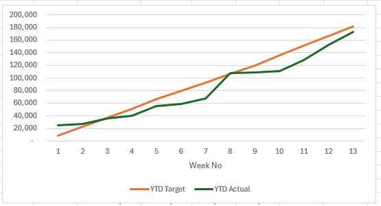

Actuals are entered by week number therefore the target needs to be split across months based on a daily target * # days in the period as below
The final measure should create an output that can be used in a chart with Week No on the x axis as below
I’ve tried creating the measure but it only ever enters anything on the 1st day of the month - see attached model
The slicers on the chart will be “Fiscal Year” and a between filter on “Fiscal Period”

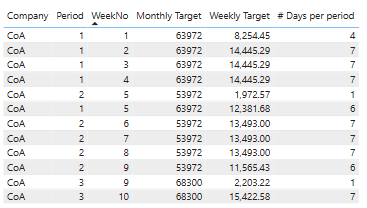

Hi @AliB - Have tried to resolve your issues based on the understanding I got from above post.
Please check attached PBIX and page “Duplicate of Measures”. There are few new measures created to solve the issue. Let me know if helps or any further help is needed.

Thank you - this seems to work :grin: however when I try to use it in a cumulative measure it only gives me data for the 1st week therefore the line chart I’m trying to create for YTD as per the post doesn’t work ?

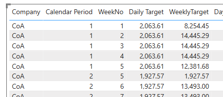

@ankit Sorry it isn’t solved. When I remove the period it doesn’t give the correct total for the week. These are the correct total
This is what the measure produces

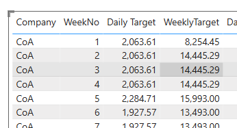

For Week 5 if we add the 12381.68 + 1927.57 we get the 14309.25 which is correct however if I remove the Period from the table we get this which puts Week 5 at 15993 instead of the 14309.25

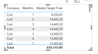

Hi @AliB - Please find attached the solution for weekly target without Period. Primarily created a new measure as below and slight changes in existing measures.
Weekly Target Final = sumx(SUMMARIZE('Fiscal Calendar','Fiscal Calendar'[Fiscal Period],'Fiscal Calendar'[WeekNo],"Weekly Target",[WeeklyTargetNew]),[Weekly Target])
