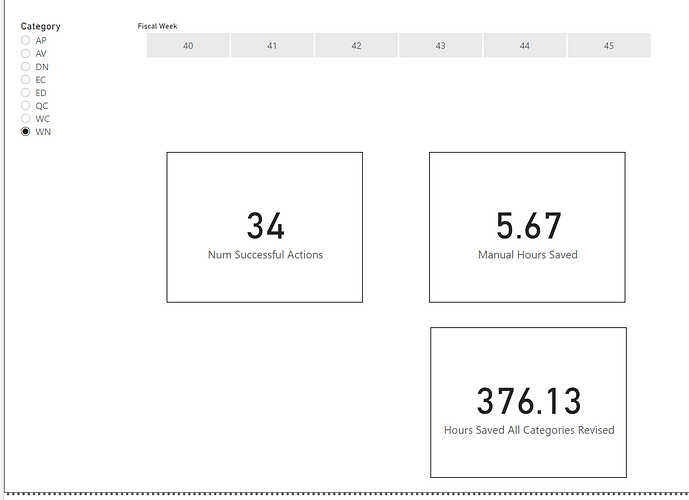

Here’s what it looks like all put together:
I hope this is helpful. Full solution file attached.

Very insightful, @BrianJ, thank you so much for this. Would love to know how we can summarize ‘manual hours saved’ across all the categories?
@Schreg ,
Okay, to summarize manual hours saved across all categories in a card visual, we have to first strip off any filters on the Category field with the ALL function. We can then use that one column table to build out the rest of our virtual table that we build within the vTable variable using the ADDCOLUMNS function. The @ManualHrsSav column is our prior Manual Hours Saved measure calculated against the evaluation context of every category, filtered by the selected fiscal week. The SUMX function just takes that virtual table and adds up all the values in the [@ManualHrsSav] column. Here’s the measure that does all that:
   Hours Saved All Categories =

This is really great @BrianJ, it allows me to see ManHrsSaved across all selected categories by week and day. Which is exactly what I was looking for. But I don’t understand what the values represent when no week is selected. I would imagine it should represent ManHrsSaved across all categories across all time, however, it doesn’t seem to be the case as that value should be much greater than what it is showing. Any ideas?
@Schreg ,
OK, knowing that FW may not be selected is helpful and only requires a couple of small changes to our prior measure:
The other thing I noticed is that there was a value for (Blank) in your slicer. This is always a big red warning light that there might be a referential integrity violation (i.e., value in your fact table that does not exist in your dimension table), which was the case. You had set up your Date table for October 2021 only, while there were Sept 2021 values in the fact table. This is part of the reason why your Date table should alyways be composed of entire years. Once that was fixed and revised measure in place, this runs like a champ…
Revised solution file attached (hopefully third time’s a charm…)
