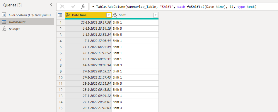

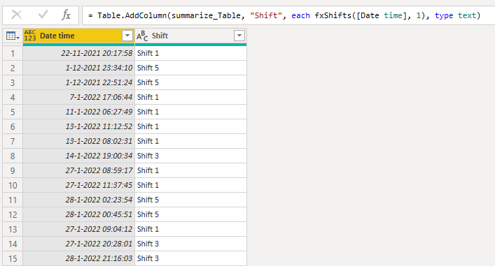

I called this function fxShifts and invoked it over your sample like so

Hi @Roger,
Please download the file again from my previous post.
Go to the Query Editor by pressing the “Transform Data” button on the Home tab of the ribbon.
First press the “Manage Parameter” button and add the full filepath to the list of values, select your location - the summarize query will then restore.

Melissa,
Got it finally to work.
last question:
For use in other PBIX files I can simply copy the code from the fxshifts function and paste it in the advanced editor?
Again many thanks for this great solution
Roger
Hi @Roger,
Yes you can transfer this custom fxShifts function to any other file, just like you would with a power query Date table function - that’s the added bonus of turning it into a custom function :wink:
