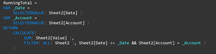

Hi @Vsb79
I noticed 2 issues in excel file. Attached screen shot below
Try this measure

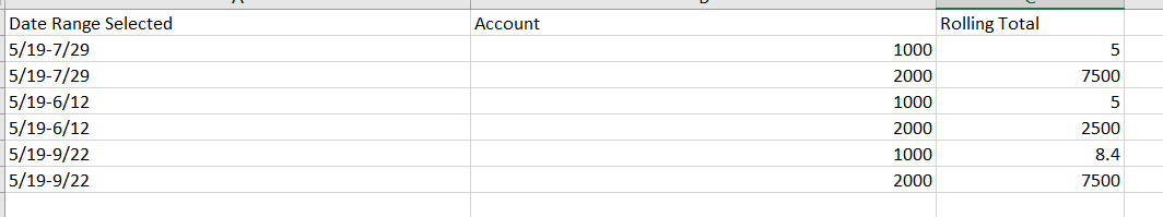

Thank you for pointing out Rajesh @Rajesh . Extending this problem, I have to calculate the sum of the max value of a column. Attaching the excel and the PBIX for reference
Running Total.xlsx (14.5 KB)
SumofMaxValues.pbix (75.7 KB)
. I have a column “Value” and it has multiple records for the same day with same value. But when calculating rolling sum, I need to pick the max value for the date and add up the totals for the dates selected. The way to go about is calculating the max value for each day and do a sumx on the max values. I was able to get to the point where I found the max value for the dates selected. But to get the totals of these max values, I am stuck. Appreciate your inputs. I tried your measure but it gives blank values for some of the date ranges.
For example
Basically, calculating the rolling sum of the max values of the date range selected is what I am trying to calculate. The starting date of the date slicer should not change the values but the values should change with the end date of the date slicer.
Thank you
Lakshmi
