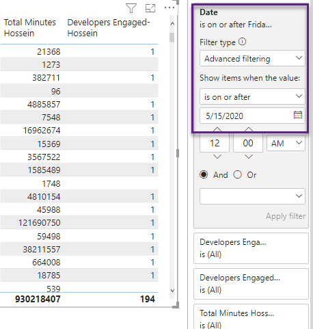

Thanks Hossein, works beautifully. (I do need to gain a better understanding of when to use column calculations versus DAX measures). One more thing: How do I hard-code a fixed Date filter (of > 5/15/20) into the DAX measure itself, so that setting a Pane filter criterion can be avoided? Somehow, my syntax must be wrong. Also, see below re: additional problem (#3) of applying a second filter criterion:
In addition (per an update of your PBIX file), I’m not able to add another criterion whereby “InTrial” column = 0. This issue is explained in Page 3. Thanks!

This is so easy in Power BI to filter dates in a measure. You just need to add a line to your code. I did It as you can see below, but the answer was 92 showing that I did not get the right answer (85). The result of the measure I wrote is different from what you got by using filter pane.
I used this code for your example:
Paid Users Hossein =
CALCULATE (
  DISTINCTCOUNT( 'Data Model _ mock'[CompanyId] ),
    FILTER( all( 'Data Model _ mock'[CompanyId]) ,
    [Total Minutes Hossein] > 2000) ,
    'Data Model _ mock'[InTrial] = 0,
     Dates[Date] >= DATE(2020,5,15))
In the last line of the above code, I filtered the date table for the dates on or after 2020/05/15.
I dont know why it doesn’t work but I hope you will find the right answer.
Thanks again. Per the validation visual below, I believe the correct answer is “69”. When I apply the usual filter pane parameters to your latest measure, the 95 then changes to 69, as shown below. Could it be my validation visual is not a valid benchmark? I have re-uploaded the updated PBIX file.Data Model with Mockup - Hossein.pbix (3.0 MB)
