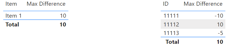

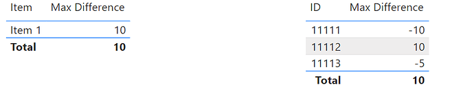

For example to calculate max price difference you can use:
Max Difference = MAXX(Sales, Sales[Price]-RELATED(SalesAgreement[UnitPrice]))
Sample Excel and Pbix file you can find at:
PriceDiffExample.xlsx (9.3 KB)
PriceDiffExample_for_Edna.pbix (22.6 KB)
Hope it helps.
Good luck with your comparison.
