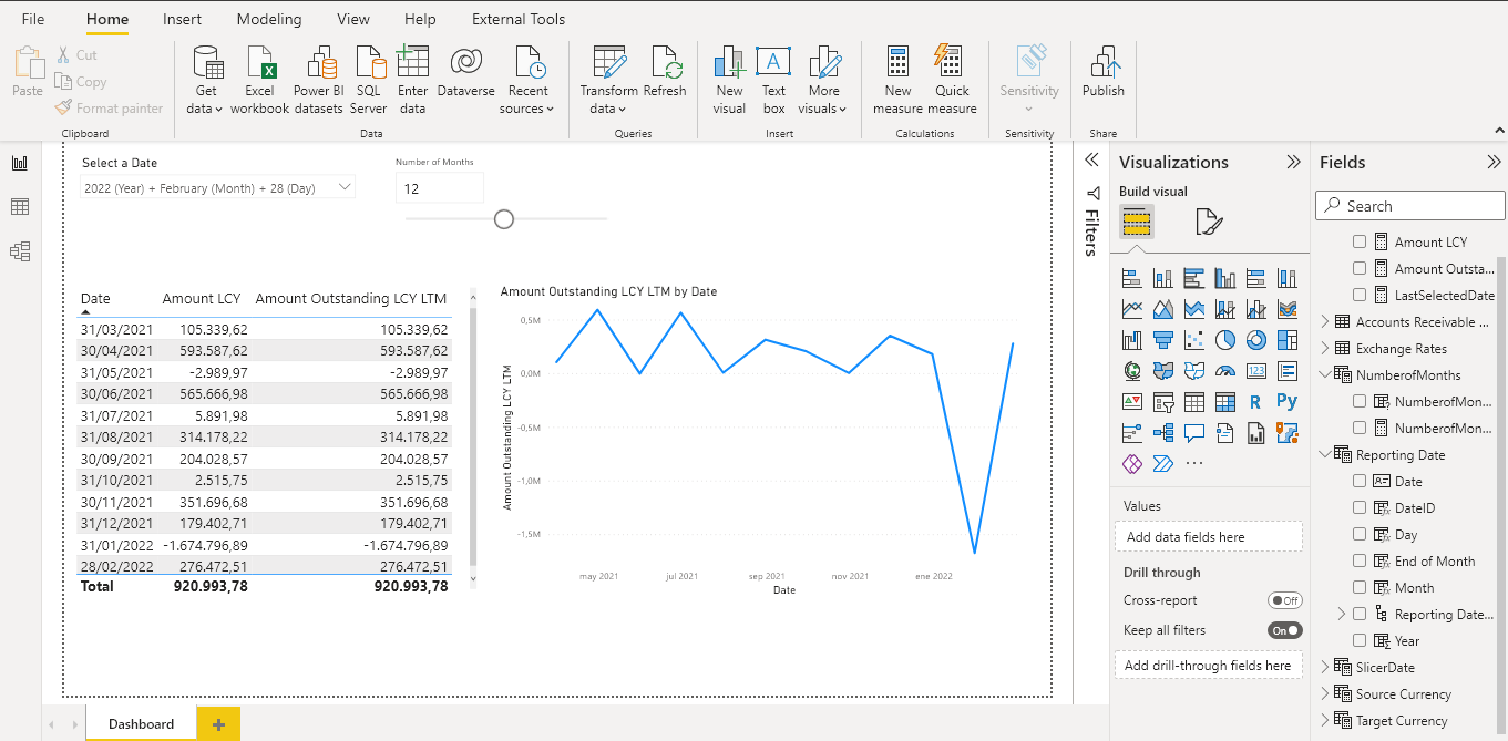

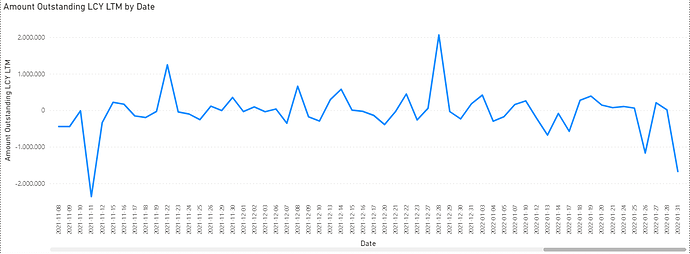

I have a measure which needs to calculate the amount all to date for the months end in a certain period. I’ve managed to create this for all the dates in the period selected, but I want it to only calculate for month’s end.
What It currently looks like:
But I want it to calculate & show only the months end:

If I alter the measure to be like this, I only get that months value:
I only want the end of months.
Thanks!

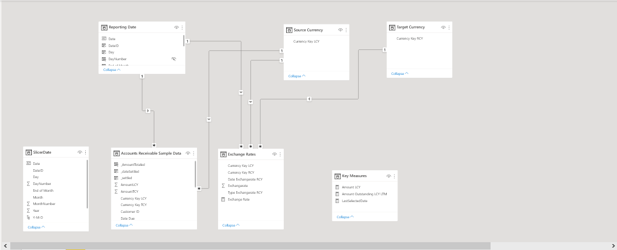

Thanks for your solution. This does indeed the trick. Do you perhaps know what I can use to have an inactive relationship between the Reporting Date table and Accounts Receivable Sample Date table? I forgot to mention this in my opening post and example.
Thanks again for your help!
Hello Benjamin,
I have modified the data model so that the Reporting Date table is the date table connected to the Accounts Receivable Sample Data fact table and I have created the SlicerDate table, which is a copy of the latter and is disconnected, since it only will use for the selection of the date on which the calculations are based.
Además he modificado la medida Amount Outstanding LCY LTM como sigue:
