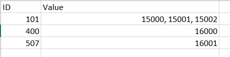

I need help with building string from a row using DAX.
For example, I have the following table with 2 columns ID and Value.
Instead of having values in the row, is there any way I can combine them in a string based on the ID. For instance, ID 101 should have values in the following format: 15000, 150001, 15002 (merged in 1 row separated by comma).
The result should look like:
Please advise…
Thank you!

You needed the CONCATENATEX function

You needed to amend the function with DISTINCT to get a unique table of values to concatenate through.

Thanks @BINavPete , It is working now.
