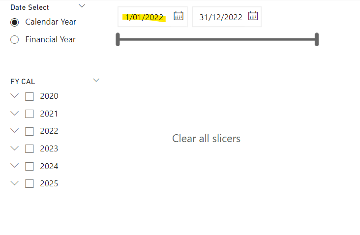

I have a report with some slicers using field parameters. I’ve created a bookmark to reset all the slicers.
When I select the following:
Scenario 1:
And then clear the selections, all the slicers reset to default
Scenario 2:
And then clear the selections, all the slicers except the date slider does not reset to default.
Is there a way to resolve this?

Hi @adsa,
Add another button to switch between the two. forcing the reset of the date slicer

Hi @Melissa ,
Thanks for the response. That works, however I can’t figure out how you how you got the different clear buttons to show/hide based on the Date select filter. Can you explain how you did this? or point me to a resource?
i.e- When Calendar is selected in the filter show 'Clear CY Button and ‘Hide Clear FY button’
Hi @adsa,
I included the “Display” for selected visuals in the Bookmark. Duplicated the Clear Button and created a new Bookmark that hides the first Clear Button and shows the second. This allows you to switch between Clear Buttons and their assigned actions.
