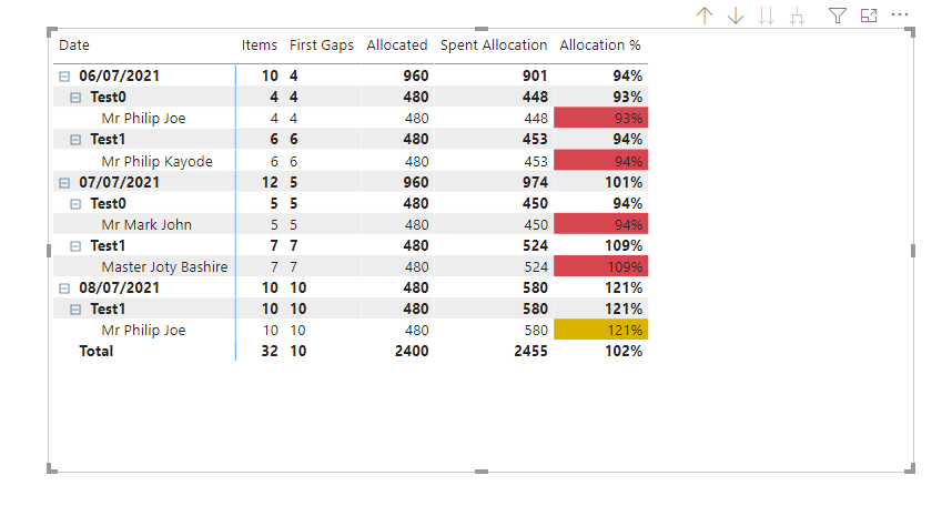

I am trying to get my formated background colour to work but it is not coming the way I expected.
From the second image, the colours should come as the values are expected to trigger the conditions to work. But is only colouring for Sales Person. I wanted it to be where ever the condition is true

In the Apply To drop down, if you change that to Values and Totals that should do all. I’ve also tweaked your boundaries a bit, as 93% was coming out as red which I don’t think is what you wanted? The real numbers behind that column will be / 100 so your rules should be the same. I may have misunderstood that part though!
