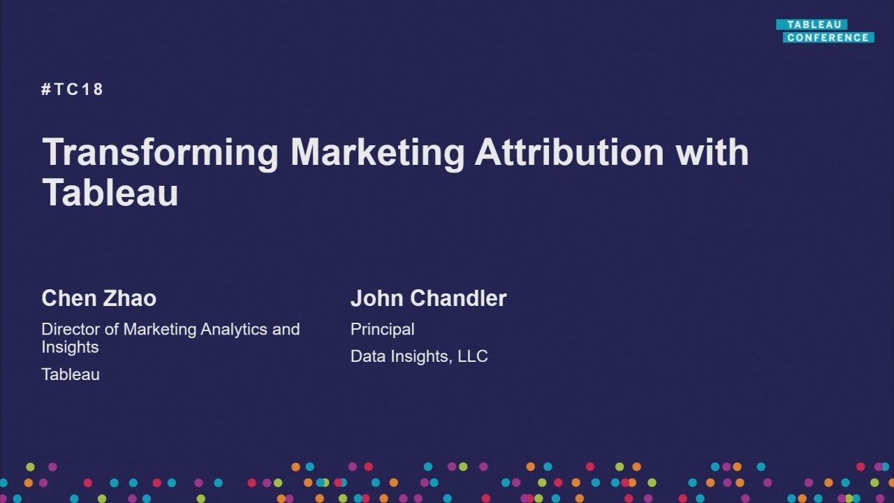

Now I found this Tableau webinar that is about attribution models and dashboard in tableau.
at about 22:26, they are sharing a sheet that has been created from data collected from Google analytics - and towards the end, presenter mentions that this data was fcompiled in R, and then exported for use in Tableau for creating dashboard and creating some scenarios based on this data.
