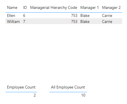

Searching for Carrie as a level 2 manager brings up 2 employees
Example Result 2

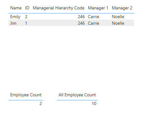

Searching for Carrie as a level 1 manager brings up 2 employees
Example Result 3

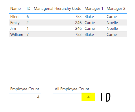

Searching for Carrie under “Any Manager” brings up 4 employees. However the result of the ALL Employee Count is now “4” instead of 10
Example Result 4.
Despite the “ALL” Function in my All Employee Count calculation
All Employee Count = Calculate(count(Employees[ID]), ALL(Employees))
The calculation is still using the the All Managers table/filter in the context. Has anyone come across this issue before? Is there a workaround or another calculation that would work to ignore any filters passed down from the All Managers Table?
