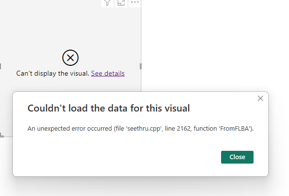

I am following along with the Dynamic Aged Receivables video. However, when I try to create the Total_Invoices measure (Total_Invoices = SUM(Invoice_Amt)) I get an error:
Screenshot 2023-07-17 130149

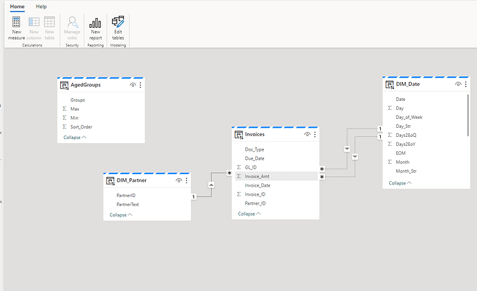

I’ve also simply tried adding the raw field Invoice_Amt to a table and I get the same error. I am able to add every other field to the table without and error (Invoice_ID, Due_Date, Invoice_ID, Invoice_Date, etc. ) There seems to be something about the Invoice_Amt field that triggers the error. I have tried clearing my cache, recreating the table and data set, and restarting my computer. Nothing seems to help. Per the videos, my data model looks like this, and both of the date relationships are inactive (dotted line).
Data Model:

I have a data set that I have created in Microsoft Fabric. It’s a relatively small table of invoices that includes Partner_ID, Invoice_ID, Invoice_Date, Due_Date, Invoice_Amt. The table is part of a dataset that also includes a DIM_Date table and a DIM_Partner table. When I connect to the dataset in Power BI, I am able to drag all the Invoice table fields into a Power Bi table visual except for the Invoice_Amt field. When I drag this field, I get an Error:
Error Message and Detail
I tried a variety of fixes I’ve seen online, including clearing my browser cache, restarting my computer, and recreating the table and dataset. I also did not find the specific error I got (file seethru.cpp; line 2162, function ‘From FLBA’) when I was researching the error. Has anyone else come across this error, and is there a know fix or workaround? As noted in my question, the Invoice_Amt field that causes the error is a decimal data type.

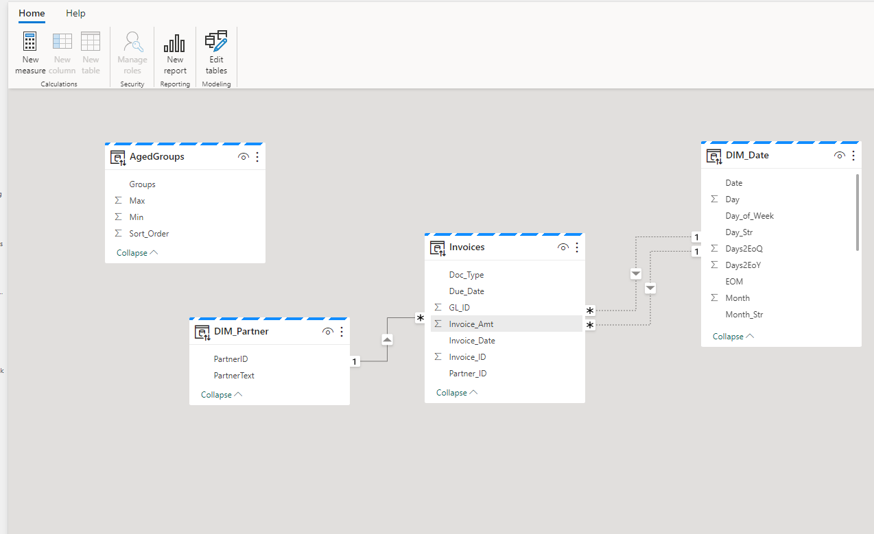

The Data Model is fairly simple - Many to 1 from Dim_Date to Due_Date and Invoice_Date (both relationships are set to inactive), Many to 1 PartnerID to Partner_ID.

After some more trial and error, I changed the data type of the Invoice_Amt field from decimal to whole number. After this change and a refresh, everything worked as expected.
For this particular data set, moving to whole numbers is OK, but I’m sure that will not always be the case. Would be nice to know what the issue is with the decimal data type.
