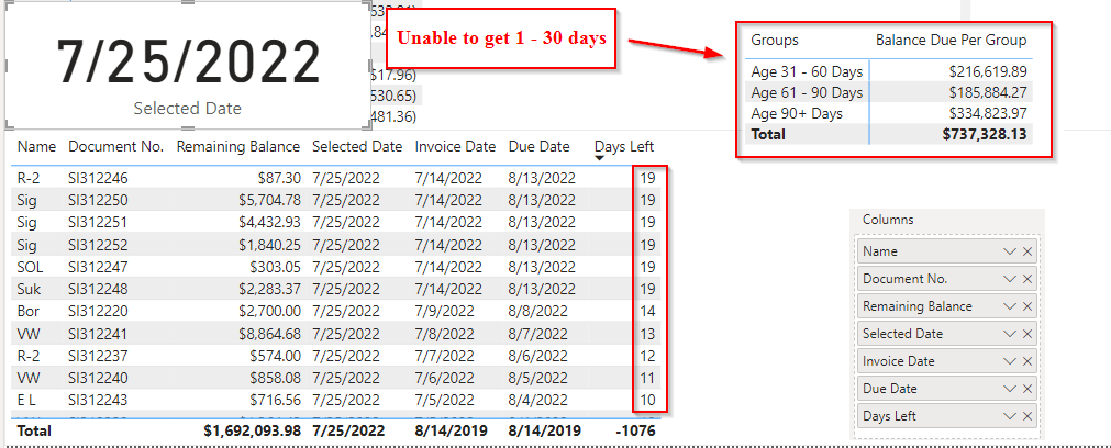

I’ve stumbled onto an issue with my dax formula. I’m hoping someone can assist me in figuring out what I could be doing wrong.
I’m working on creating a Customer Remaining Balance report. Essentially I was going off the Aged Trial Balance demo from the Financial Reporting videos. Only this report, I need to show overdue balances.
I created an “Aged Debtor Group” table, like so;
To calculate the Days left, I used the following DAX formula;

The issue I’m facing is that I can’t get the 1 -30 days group to show up in my Matrix table. I have tried different variations in those formulas, and some would give the same results, but no matter what I try, I can’t get the first group to show up.
The normal table shows days less than 30 based on the selected date; I’m just not sure what I’m missing here to get it to appear in my Debtor group/matrix table.

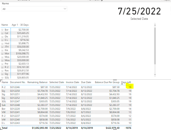

Hi ,
I think the problem lie here in the && condition you put
It should be [Day left]>=min && [Day left]<=max .
For example 10>=1 && 30<=30 so it fall on first group 1-30 .
As per your data the max date diff is 19 as i find out in report:
So evert thing fall under first category.
Hope i understand your query well and provide you a solution for the same let me know incase i miss anything i attached the pbix which conation the sol also for your help.

Hi Anurag,
Thank you for the reply. That was how I initially had the DAX formula. The issue is that when I switch the operators like that, I get the Aged Group from 1 - 30 days, but then it doesn’t filter and display the other three Aged Groups (30 - 60, 61 - 90, and 90+).
I believe I found out what the issue was, my Aged Debtor Group table, and how I had it set up.
The outcome I wanted to achieve was to display all current invoices which aren’t overdue (within the selected date) and then display overdue ones (based on the selected date).
Silly me realized I needed to change up how I had my Aged Debtor Group table, and all I needed to do was to change it like so;
After that, my report worked as intended, at least from what I can tell. I will give it to accounting, and they will tell me otherwise :stuck_out_tongue_closed_eyes:
