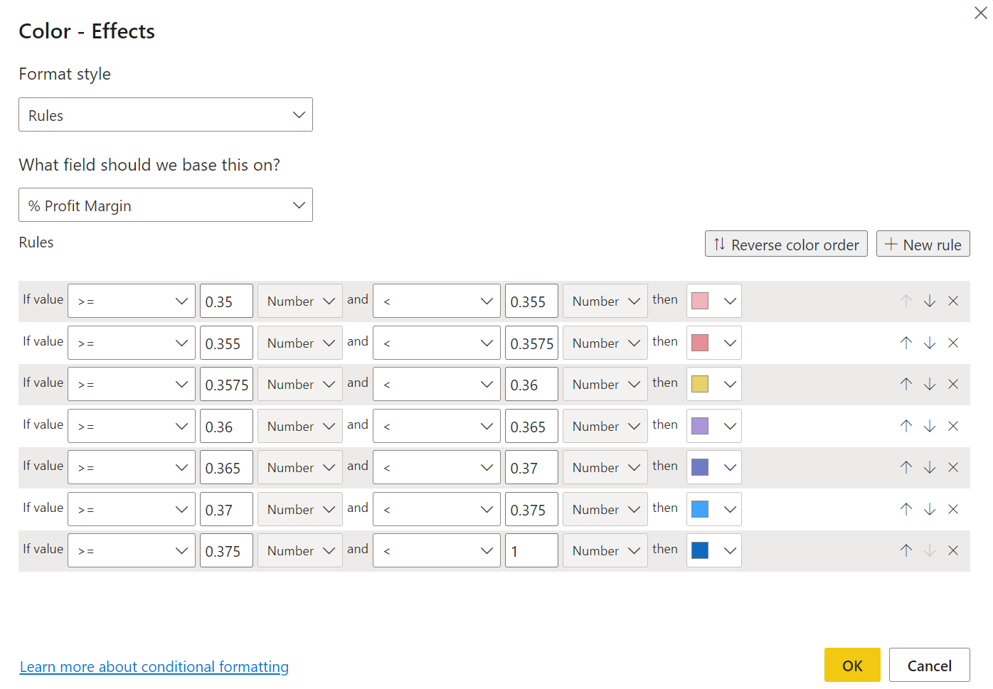

I am trying to setup conditional formatting for the Advance Card custom visual from MSFT App Source. This visual allows for (I think) up to 6 conditions to be set for formatting the card. I’d like the background to change based on the measure’s range of data points:
< 65% - - Green
= 65% up to 85% - - Yellow
85% up to 100% - - Orange
100% > - - Red
I am not sure this is possible with this visual. It works well if I set just the first two conditions as < 65 and > = 65, but once I try to add more conditions then what should be Orange and Red just stay as Yellow. There is no “in-between” condition, only these 5 are available: <, <=, =, >, >=.

Hello @s_schwantes,
Well, how the members of the forum will come to know which custom visual you’re using in your report without providing the actual name of that visual.

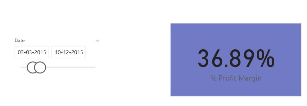

Anyways, not sure about that visual options but the native card visual in Power BI allows you to set-up more than 6 conditions, if that’s the case.
Below is the screenshot provided for the reference -
Hoping you find this useful and meets your requirements.
Thanks and Warm Regards,
Harsh
Conditional Formatting in a Card Visual - Harsh.pbix (657.5 KB)

Harsh,
Thanks very much for pointing out this native solution. I didn’t need the custom visual after all. BTW the custom visual name is “Advance Card” and can be found on app source here:
Business Apps – Microsoft AppSource
Thanks!!
