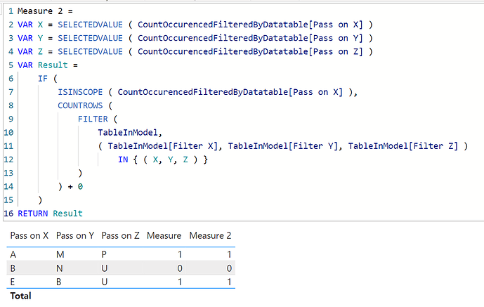

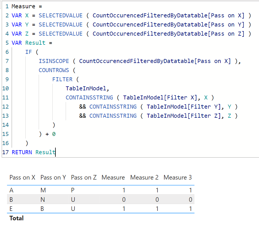

I was thinking about doing something like:
var result =
ADDCOLUMNS(ToBeCheckedDatatable,
countrows(treatas(summarizecolumns(Filter X,Filter Y, Filter Z),Pass on X,Pass on Y,Pass on Z))
But I cannot reference the Pass on X,Pass on Y,Pass on Z because they are columns of a table created in a variable.
Any assistance would be more than welcome!
@Wlknsn edna - datatable evaluation.pbix (21.4 KB)
The virtual table “CountOfOccurenceFilteredbyDatatable” is not a table in the model. I can only pass it on as a variable hence I cannot reference its column so not sure if any of the above works.
Your requirement isn’t clear, use the code I have shared play with it and try to implement in your scenario.
That’s the point. Just add the datatable as a variable in your code and you can’t reference it. So i can’t play around with your code.
What you did was create a table first and then add measures (this is I can do too), the problem is that I have to pass that data as a variable within a measure.
I know “filter” can reference a column from a table in a variable but can’t make that work to calculate the occurrences in another table.
Added to the title also “passed as variable”
Nope, adding the datatable to any of those measures and referencing doesn’t work at all. All of the above is when the datatable is made part of the model first, which is not the ask as pointed out in the introduction and provided in the sample powerbi where this was part of the measure already.
