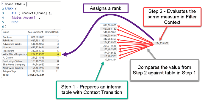

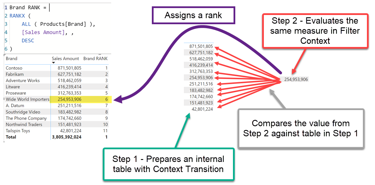

RANKX has to build an internal lookup table so if you have 10 brand in a Matrix and you use ALL then all those 10 brands are used to build a table that will contain let’s say Sales Amount for each Brand this lookup table is built using Context Transition where CALCULATE transforms the currently iterated row into an equivalent filter context, RANKX has to evaluates the same measure used in the filter context as well.
RANKX perform 2 important steps
  1. Evaluate the same measure [sum of values] in the row context of the table supplied All(Products[Brand])
  2. Evaluate the same measure in external filter context so that it can compare this value against the internal table prepared in step1.
But if you don’t use ALL or ALLSELECTED then RANKX will prepare a lookup table of 1 Brand and Will compare the same value from step 2 against same value from step 1, that’s why you will see the RANK as 1
And at Grand Total you will get 1 because 3.8 Billion is greater than any value in the table prepared in Step 1
