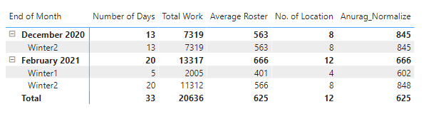

if you see below pic
Dec has been normalised correctly but Feb’2021 is normalising as well. so For Feb it should be left unchanged 401+566 and the subtotals are not adding up as well.
Thanks so much buddy.
Cheers
M

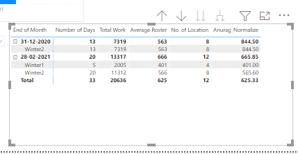

Yes very close mate… :slight_smile: Just sub total and total in Feb '21 it is currently showing 665.85 but it should be 401+565 = 967 and Total should be 844.5+967=1811.5

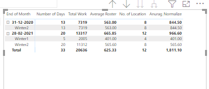

HI,
Is it good:
Magical :slight_smile: :+1:. Can you please share the pbix

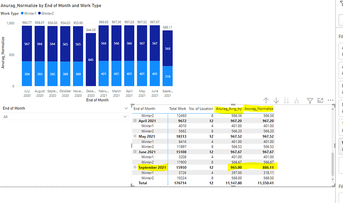

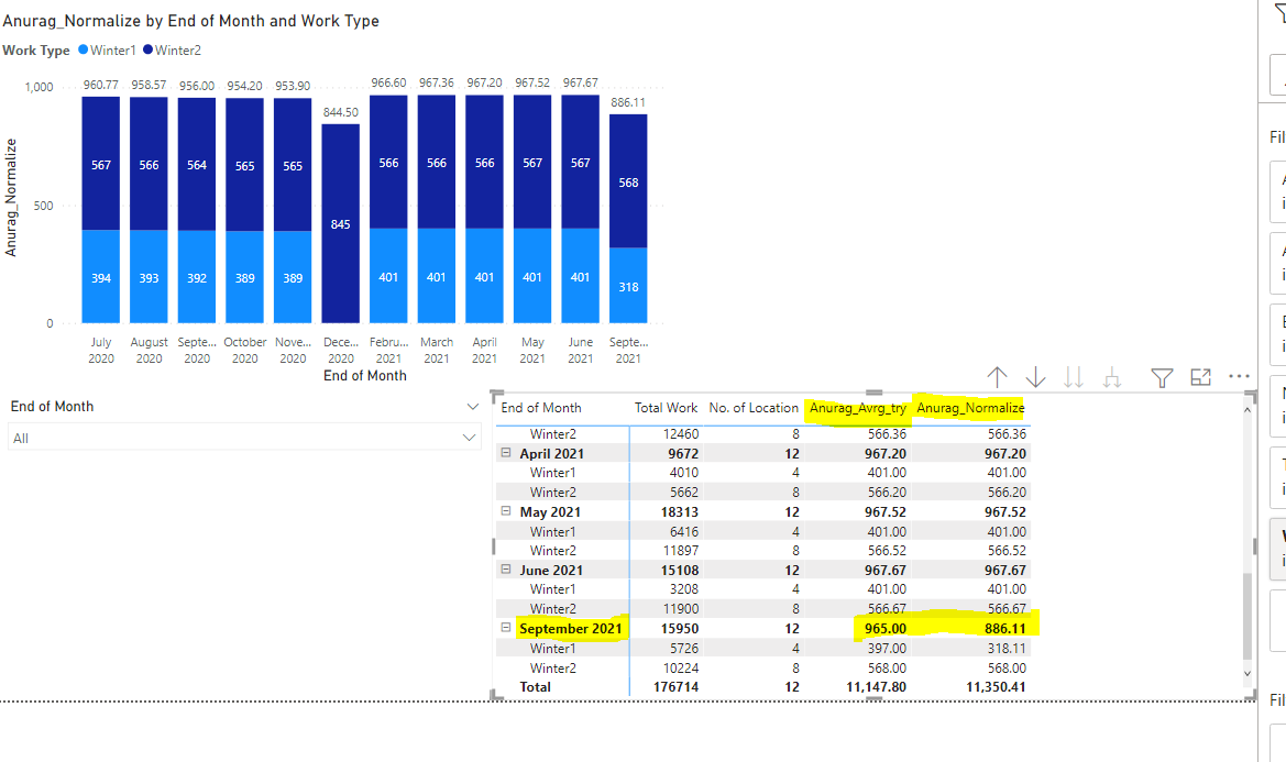

Buddy I can’t thank you enough… looking very good and it is working perfectly. Just one minor issue.
September 2021 Winter 1 should be 397 not 318, this is the same issue which you created a measure for tab 1 and 2 to resolve the different number of days between AIEH hence difference from 397 to 318.
